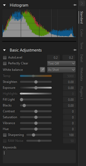

Most editing tools and controls can be found in the Tools panel. When you click the Standard tab, you can access the Basic Adjustments section, which contains the most common adjustment controls. Other tabs, such as Color, Tone, Detail, and Metadata, let you access additional tools and more advanced controls and options. For example, the Basic Adjustments section includes Fill Light. Fill Light also appears in the Exposure section of the Tone page. In the Exposure section, there is an additional control, Range, that lets you fine-tune the Fill Light adjustment. Adjusting Fill Light in one place will update the Fill Light setting in all sections — these are just different views of the same control.
The image below shows , and some common controls. The Tools panel can be resized, sections can be pinned, and you can choose to hide or show the panel. There are different ways to adjust the controls in the Tools panel. You can also reset controls to their original setting and hide or show the results of a setting.
The Basic Adjustments section of the Tools panel
