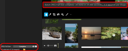

There are many factors that determine the processing speed when you use OpenCL, including which OpenCL Utilization setting you use. To find out which setting is best for your system, you can run a speed test. Basic test instructions are outlined on the Hardware Acceleration preferences page.
To guage speed, you can view total processing time and average time per image after the processing is complete.
