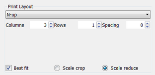

The N-Up layout allows you to specify how many images to print on a page, in rows and columns, with the designated amount of spacing between cells.
For example:
