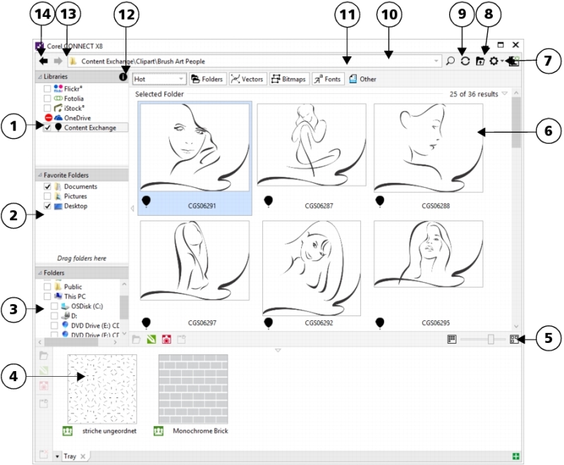

Corel CONNECT is a standalone utility for finding and managing content. It is included in CorelDRAW Graphics Suite.
The image below shows the main components of the Corel CONNECT utility:
1. Libraries pane
2. Favorite folders pane
3. Folders pane
4. Tray pane
5. Zoom slider
7. Help and options button
8. Go to parent folder button
9. Refresh/Cancel button
Reloads the results from your last search or initiates a new search based on the criteria that you have specified. When a search is in progress, the button changes to the Cancel mode , which allows you to stop a search at any time.
10. Search and address box
11. Filter toolbar
12. Configure content libraries button
13. Navigate forward button
14. Navigate back button
You can also customize Corel CONNECT by changing the color of its borders.
You can customize the size and display of individual panes.
You can use the Favorite folders pane to create shortcuts to folders that you visit frequently. You can add locations to and remove locations from the Favorite folders pane.
