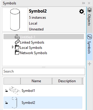

You can access a new symbol by selecting the active document (Untitled-1) in the Symbols docker.
You can edit a local symbol; any changes you make affect all symbol instances in the drawing. The selection handles for symbol instances differ from those for objects. Selection handles for symbols are blue; selection handles for objects are black.

In the Symbols list, local symbols appear with open-lock icons that show they can be edited and renamed within the drawing.
