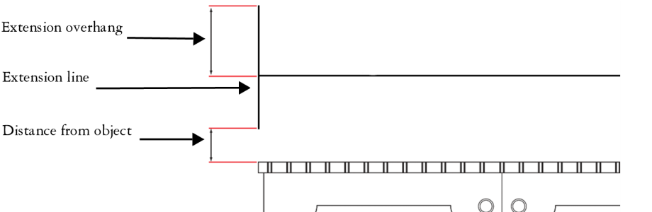

If you are not satisfied with the look and position of the dimension lines you added, you can edit them. You can set how dimension text and lines are displayed. For example, you can choose the unit of measurement, specify the position and font of the dimension units, and add a prefix or suffix to dimension text. You can also customize the extension lines on which dimension lines rest. You can specify the distance between the extension lines and the object that is measured, and the length of the extension overhang. Extension overhang is the portion of the extension line that falls beyond the dimension arrows.
By default, dimension text is dynamic. If you resize the object to which a dimension line is attached, the dimension text is updated automatically to display the new size. However, you can make the dimension text static, if necessary.
When a dimension line is so small that its arrowheads overlap, the application automatically places them outside the leader lines.
Arrowheads are reversed when a dimension line is too small.

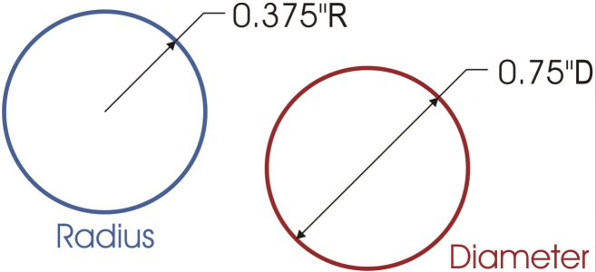

To draw a radial or diametric dimension line
Back to Top
1 Click the Radial dimension or Diametric dimension tool.
2 Click a circle or an arc, and drag to where you want the line to change direction.
You can hold down the constrain key while dragging to constrain the leader line to the current constrain angle.
3 Move the pointer, and then click to place the dimension text.
If you want to add a symbol to the dimension text, choose a symbol from the Dimension symbol list box on the property bar.
If you transform a circle to an ellipse after applying a radial or diametric dimension line, the dimension measurement does not appear. When you transform the ellipse back to a circle, the correct measurement is displayed.
Examples of radial and diametric dimension lines
