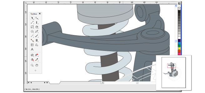

To pan in the drawing window while zoomed in on the drawing, click the Navigator button in the lower-right corner of the drawing window.
Using the Navigator (lower-right), you can display any part of a drawing without having to zoom out.
