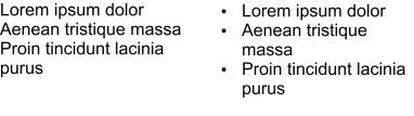

Three paragraphs (left) were converted into a bulleted list (right)
