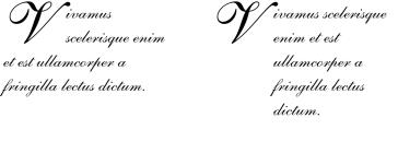

You can add a drop cap (left) or a hanging indent drop cap (right).
