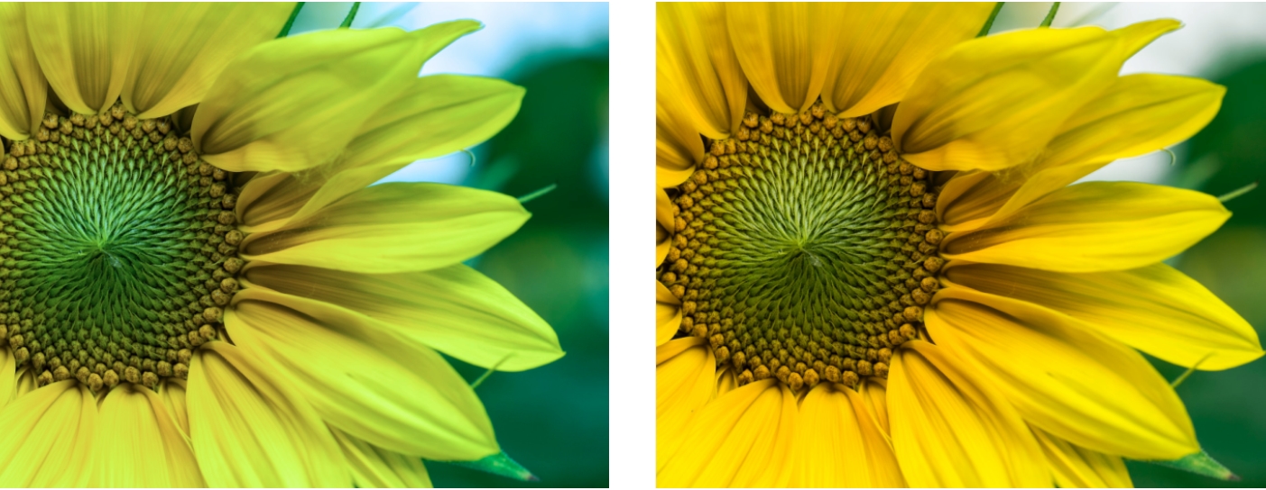

The Auto-adjust filter equalizes the shadows, midtones, and highlights in an image by automatically redistributing the significant pixel values throughout the tonal range. This adjustment is performed on each color channel of the image, resulting in changes to the color and tone of the image.
Original image (left); the image with Auto-adjust applied (right)

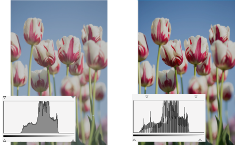

Contrast Enhancement
Back to Top
The Contrast Enhancement filter lets you adjust the tone, color, and contrast of an image while preserving shadow and highlight detail that is lost when you adjust the brightness, contrast, and intensity of an image. An interactive histogram lets you shift or compress brightness values to printable limits. The histogram can also be adjusted by sampling values from the image.
Original image (left); the image with Contrast Enhancement applied and expanded tonal range (right)
To adjust image tone interactively by using a histogram
1 Click Window Inspectors Adjustments.
2 Click the Add adjustment button , and click Contrast Enhancement.
3 Move the Input arrows, located above the histogram, to adjust shadows and highlights.
The arrow on the left lets you darken shadow areas. The new black point value is mapped to the Output value for shadows, which is 0 by default.
The arrow on the right lets you lighten highlight areas. The new white point is mapped to the Output value for highlights, which is 255 by default.
4 Move the Gamma slider to adjust the midtones.
5 Move the Output arrows, located below the histogram, to fine-tune the contrast.
To lighten dark areas, move the left arrow to the right.
To darken light areas, move the right arrow to the left.

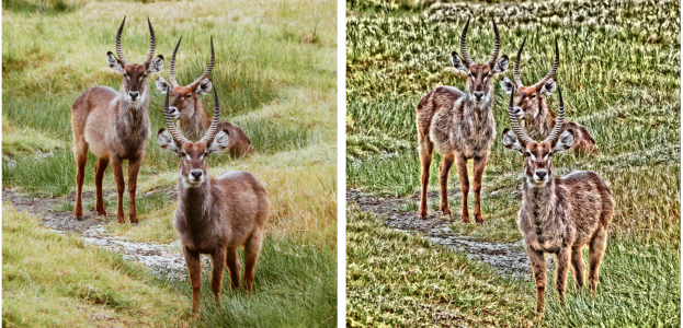

The Local Equalization filter lets you enhance the contrast near image edges and reveals details in both light and dark regions. The filter uses neighboring pixels to create a stylized effect.
Original image (left); the image with Local Equalization applied (right)

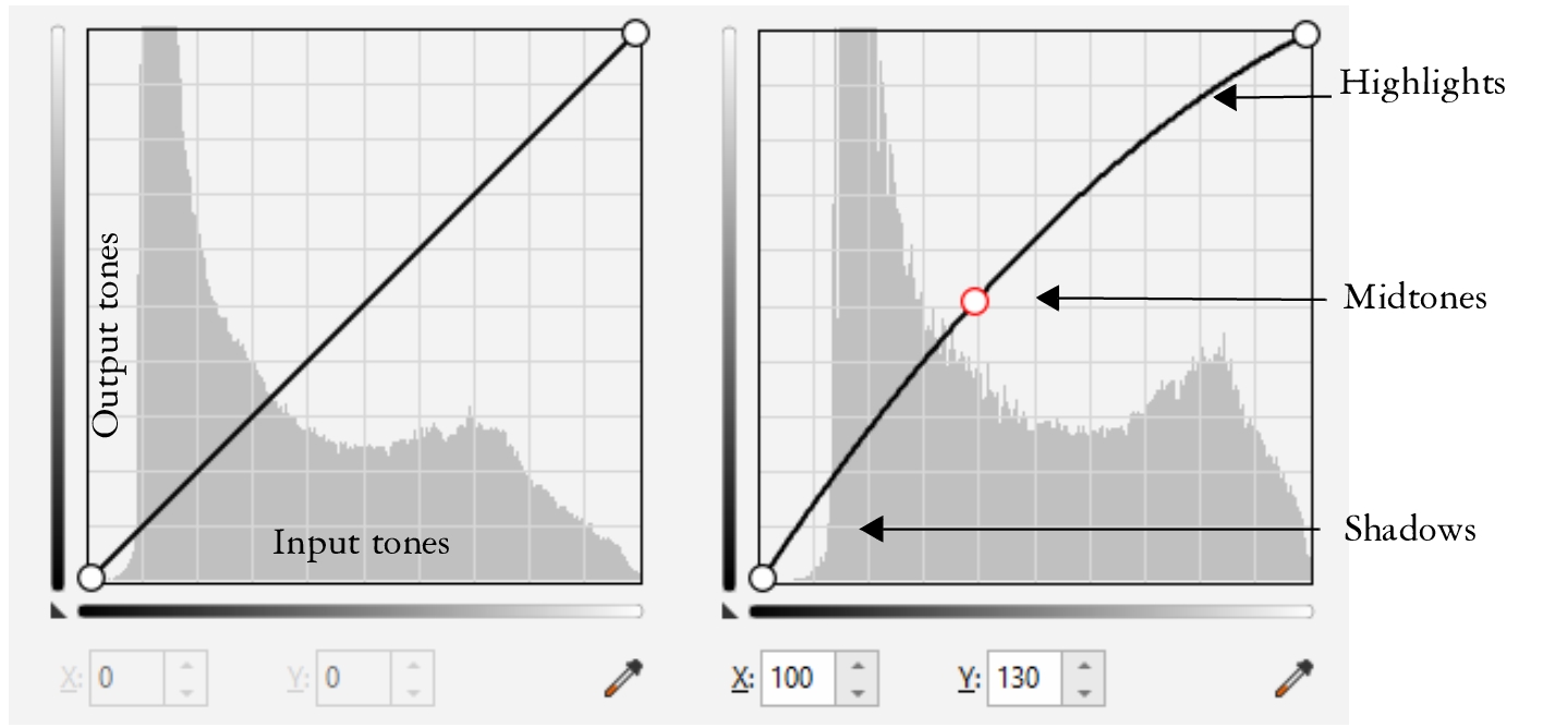

Tone Curve
Back to Top
The Tone Curve filter lets you perform color and tonal corrections by adjusting either individual color channels or the composite channel (all channels combined). Individual pixel values are plotted along a tone curve that appears in a graph and represents the balance between shadows (bottom of graph), midtones (middle of graph), and highlights (top of graph). The x-axis of the graph represents the tonal values of the original image or the input values; the y-axis of the graph represents the adjusted tonal values or the output values.

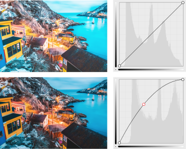

The tone curve shows the balance between the shadows, midtones, and highlights of an image. (left) The tone curve of an image before tonal adjustments. (right) This example shows a small adjustment to the tonal range, in which pixel values of 100 are replaced with pixel values of 130 to lighten the midtone areas.
You can fix problem areas by adding nodes to the tone curve and dragging the curve. If you want to adjust specific areas in an image, you can use the Color eyedropper (Sample tone from image) tool and select the areas in the image window. You can then drag the nodes that appear on the tone curve to achieve the effect you want.
Original image (top); the image with adjusted tonal range (bottom)
The histogram lets you view the adjusted tonal range and evaluate the results. For more information about histograms, see Histograms.
To fine-tune your adjustments, you can choose a curve style from the Style list box. For example, you can redraw the curve by using freehand lines or straight line segments.
In addition, you can equalize the tonal range of an image by clicking the Auto-balance tone button. To specify the outlying pixels (clipped pixels) at each end of the tonal range, you can click the Black and White limits button and type values in the White limit and Black limit boxes.
You can apply this adjustment non-destructively from the Adjustments inspector or the Effects inspector, and destructively from the Adjust menu.
When accessing the Tone Curve filter from the Adjust menu or the Effects inspector, you can adjust the color and tone of an image by applying a preset from the Presets area. You can also save tone settings as presets to use with other images.

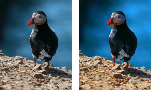

The Replace Colors filter lets you replace colors in an image, editable area, or object. When you select the color you want to replace, the application also automatically selects a range of similar colors to be replaced. You can select the original and replacement colors from the image or from a color picker.
The Replace Colors adjustment has been applied to replace all reds with purple.

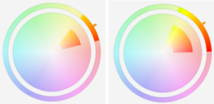

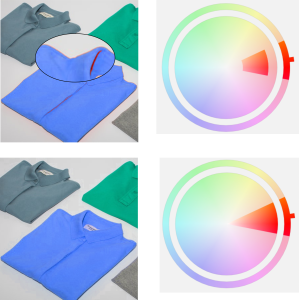

To add or remove colors from the selection, you can adjust the hue and saturation range. You can also select and replace a single color in the image. To prevent abrupt color changes, you can smooth the transition between selected and unselected pixels. You can also set the hue, saturation, and lightness for the new color.

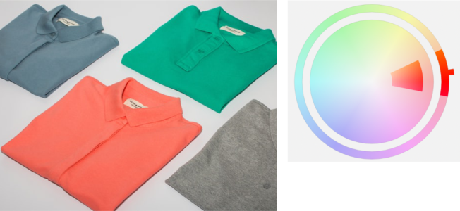

An orange color was selected from the image.
The orange in the shirt is replaced with blue, but some orange and red colors still remain (top). The saturation range is adjusted to select and replace those colors (bottom).

The Range control show the range of selected colors.

Adjust the selected hue range
Point to one of the edges of the color band on the Hue range ring, and when the hand cursor appears, drag up and down.
To shift the entire hue range of selected colors, click the handle of the color band on the Hue range ring, and drag around the ring.
Note: When the color band is small, only pixels that are very similar to the color you selected are selected and replaced; when the color band is bigger, more pixels are selected and replaced.
Adjusting the selected hue range
