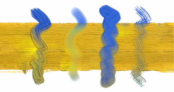

Sample brushstrokes: Thick Paint Bristle (left) and Thick Paint Palette Knife (middle and right)

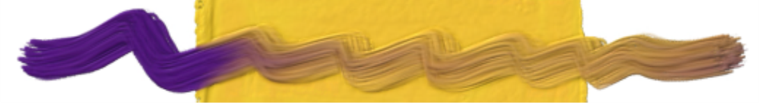

Thick lets you add thick, rich brushstrokes that have a very pronounced impasto effect.

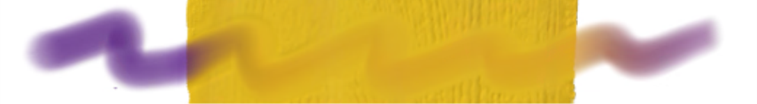

Soft lets you apply smooth, flat, and fluid brushstrokes that are ideal for adding detail to an image or filling large areas.

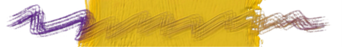

Thin lets you apply thin brushstrokes that lightly cover existing strokes and can reveal some paper texture.

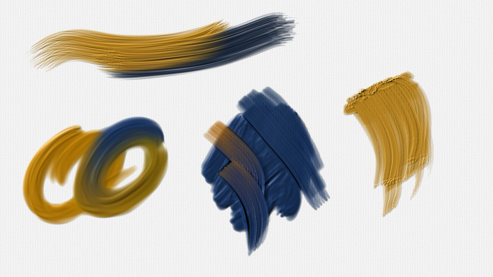

Brushstrokes made with the same brush but with different technique presets applied: Thick, Soft, Thin, and Dry.
