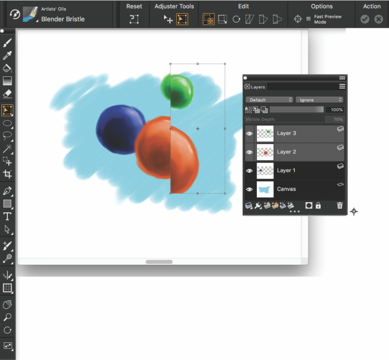

An example of selecting multiple layers for performing a transformation
An example of applying a transformation across multiple selected layers

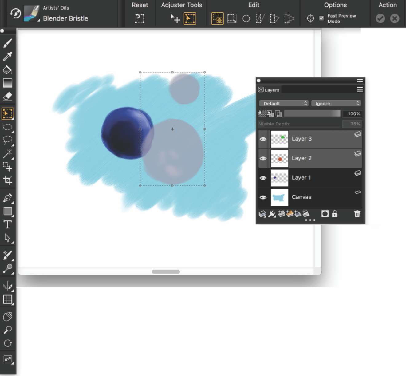

To speed up the process of applying transformations to multiple layers or a layer group, you can enable the Fast Preview Mode. During the transformation, only a grayscale rendering of the layers displays in the document window, instead of full-color details. You can turn off the Fast Preview Mode to reveal the full-color results. For example, you may want see the transformed layers in full-color before committing the transformation.
Fast Preview Mode displays the selected layers in grayscale to perform the transformation more quickly.
