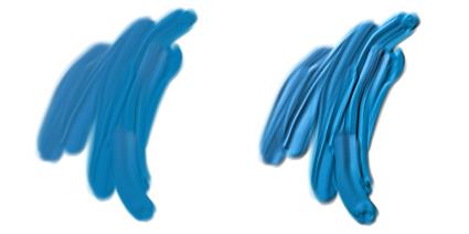

Thick Paint brushes work on special Thick Paint layers. You can experiment with the Thick Paint layer settings to control the appearance of thick paint on the layer. Increase the amount of thick paint to increase the height of the elevated areas in the brushstrokes, creating a more pronounced thick-paint effect. Alternatively, you can decrease the amount for a more subdued thick-paint effect.
Thick Paint Amount values: low (left); high (right)
You can set the Thick Paint Amount to 0 to create flat brushstrokes. This can help you take advantage of the superior blending power of Thick Paint brushes while you use them as regular brushes.
