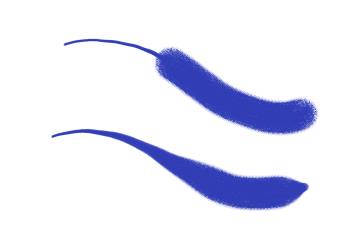

Abrupt changes in the width or density of your strokes shows that you need to adjust your Brush Tracking preferences.
Top: A brushstroke with abrupt changes in width. Bottom: A similar brushstroke with adjusted brush tracking.

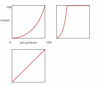

In addition, Corel Painter includes the following brush tracking presets that you can choose from: Default, Legacy, and Linear.
The graph in the Brush Tracking dialog box shows how increasing the pen pressure affects brushstrokes, which are referred to as "output" in the graph.
The graphs for the Default preset (upper left), the Legacy preset (upper right), and the Linear preset (lower left)

Default — suitable for most artists. The preset also provides a good starting point for brush tracking adjustments. |
Legacy — default brush tracking in Corel Painter X3 and earlier versions |
Linear — pressure changes impact the brushstroke in a linear fashion. Each small variation in pen pressure changes the brushstroke. |
