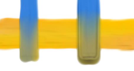

Bleed controls how much the brushstrokes blend with existing paint. With low bleed values, brushstrokes tend to cover existing colors. With higher bleed values, brushstrokes blend better with existing colors.
Bleed: low (left), high (right)

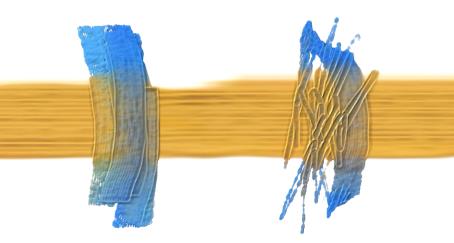

The controls in this area have an effect only on Thick Paint Palette Knife brushes.
Corner Tilt allows you to use the tilt of your stylus to vary the angle of the palette knife. When you disable the Corner Tilt check box, the palette knife angle does not change: the palette knife remains flat, and the brush mark shape remains the same.
Corner Tilt disabled (left); Corner Tilt enabled (right)
Left to right: brushstrokes with and without corner tilt
Start lets you set the tilt angle of your stylus at which the palette knife starts to transition from corner to flat.
End lets you set the tilt angle of your stylus at which the palette knife becomes flat. The angle and brush mark of the palette knife change only when you tilt the stylus within the range set by the Start and End angles.
Start tilt angle of the stylus (left); end tilt angle of the stylus (right)
Strength lets you adjust how much paint is displaced by the brush.
Strength values: low (left), high (right)
Brushstrokes with low plow strength (left) and high plow strength (right)
