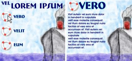

When a hotspot is clicked (left), the browser jumps to the page referenced by that link (right).

A client-side image map is an image that has "hotspots" directly associated with URL information. When a hotspot is clicked, the browser jumps to the page referenced by that link.
