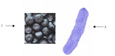

An area of an image was selected (1) to create a flow map (2).

To capture a flow map from an image |
1 | Open or create an image. |
2 | Choose the Rectangular Selection tool from the toolbox. |
3 | Drag in the document window to select the area of the image. |
4 | In the Flow Maps panel, click the Flow Maps options button , and choose Capture Flow Map. |
If you want to blend the distinction between tile borders, drag the Crossfade slider to the right in the Capture Flow Map dialog box. |
5 | Type a name in the Save As text box. |
The flow map is added to the currently selected library. |
You can also capture a flow map from the Flow Map Libraries panel by clicking the Capture Flow Map button .
