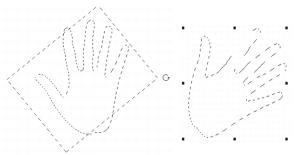

To rotate a selection |
1 | In the toolbox, click the Transform tool . |
If the Transform tool is not displayed in the toolbox, click and hold the Layer Adjuster tool to open the flyout, and then choose the Transform tool . |
2 | On the property bar, click the Rotate button . |
3 | Move the pointer outside the border of the selection’s bounding box. |
4 | Drag a corner handle. |
If you want to constrain the rotation by 15-degree increments, hold down Shift while dragging. |
5 | On the property bar, click the Commit Transformation button . |
You can also Rotate a selection by choosing Edit Transform Rotate, and specifying the rotation angle in degrees in the dialog box. A positive number rotates clockwise; a negative number rotates counterclockwise.
