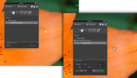

To remove a spot with Heal
| 1. | Click the Open Layer Manager button |
| 2. | In the Layers palette, click the +Heal/Clone button. |
| 3. | Click the Circle Region tool, and in the Preview panel, click the spot that you want to remove. |
| 4. | In the lower-left corner of the Layers palette, choose Heal from the Mode drop-down menu. |
If you want to adjust the size of the circle or how the edges of the circle blend, drag the Size or Feather sliders at the bottom of the Layers palette.
The Heal mode was used to remove a small white spot from a flower

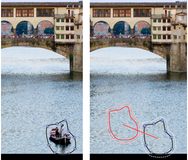

To cover or copy image areas by cloning
| 1. | In the Layers palette, choose an existing Heal/Clone layer or click the +Heal/Clone button to create a Heal/Clone layer. |
| 2. | Click a Region tool. |
| 3. | Select the portion of your image that you want to clone out. This is the destination area for the cloning. If you used the Circle tool, make sure the Mode is set to Clone. For information about using regions tools, see To create a region. |
| 4. | After you finish creating your destination region, a source region is automatically created (outlined in red). Click and drag the source region to position it over the image content that you want to copy. |
Tip: When cloning, you can click the Swap Source button at the bottom of the Layers palette to swap the source region with the destination region. This is useful when you want to duplicate content in an image instead of using cloning to remove image content.
