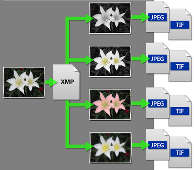

Versions are used in Corel AfterShot Pro to represent your master files and any variations derived from your master files. When you make edits and image adjustments in Corel AfterShot Pro, you are creating and editing versions, not the original master file. This means you can make as many different versions from a single master file as you like, without ever affecting the original image.
Versions created from the same master file share the same content and are shown in a stack — a set of thumbnails that can be grouped together so that only the top thumbnail shows in the Thumbnail panel. All settings and options can be different, allowing you to make different interpretations, crops or other image adjustments to each version. Versions maintain their own edit history, and can each be assigned unique metadata. The settings for all versions from a single master file are stored inside a single Corel AfterShot Pro XMP file.

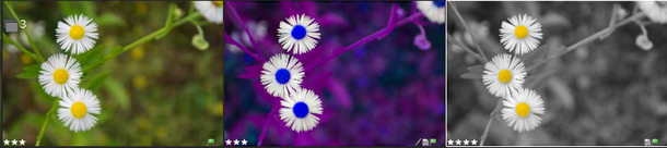

In the example above, the thumbnail on the left is the master version. To the right are two additional versions that have been edited. The number 3 appears on the upper left corner of the master version thumbnail to indicate the total number of versions.
