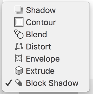

The Block Shadow tool is located on the Interactive tool flyout.
