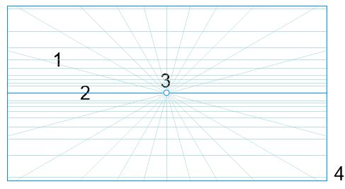

The perspective field includes a grid of perspective lines that converge towards one, two or three vanishing points. The visible part of the perspective field is called viewport.
Elements of a perspective field: Perspective grid (1), horizon (2), vanishing point (3), viewport (4)

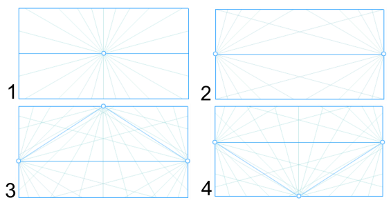

CorelDRAW provides presets for three types of perspective: one-point, two-point and three-point perspective.
One-point — creates a perspective field where all lines recede from view towards one vanishing point
Two-point — creates a perspective field where all lines recede from view towards two vanishing points
Three-point (worm’s-eye view) — creates a perspective field where all lines recede from view towards one of three vanishing points. This preset helps you create views as seen from below.
Three-point (bird’s-eye view) — creates a perspective field where all lines recede from view towards one of three vanishing points. This preset helps you create views as seen from above.
Perspective types: (1) one-point, (2) two-point, (3) three-point (worm’s-eye view), (4) three-point (bird’s-eye view)

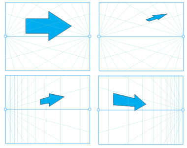

Before you start drawing in the perspective field, you can choose the plane you want to draw on. You can choose to draw on an orthographic plane, which is a flat plane without perspective, on the top perspective plane or on one of the side perspective planes.
(left to right) The same object placed on four different planes: orthogonal, top, left, and right.

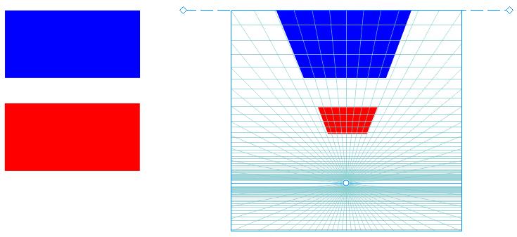

Perspective drawing assumes that the viewer or the camera is at a certain distance from objects. All objects are scaled relative to the viewer. In CorelDRAW, the position of the viewer is indicated by camera lines, which you can use as a drawing aide to place objects. Camera lines are linked to the active perspective plane and are hidden by default. After displaying a camera line, you can move it to increase or decrease the distance between the viewer and the depicted objects. Moving a camera line doesn’t change existing objects, but impacts how an object appears when it is moved to the active plane. If an object side aligns with the camera line, that side appears at 100% - it is not shortened or lengthened. Object sides or objects that appear at a distance from the camera line will appear smaller than their actual size.
The red rectangle is further away from the camera line so it appears smaller than the blue rectangle.
