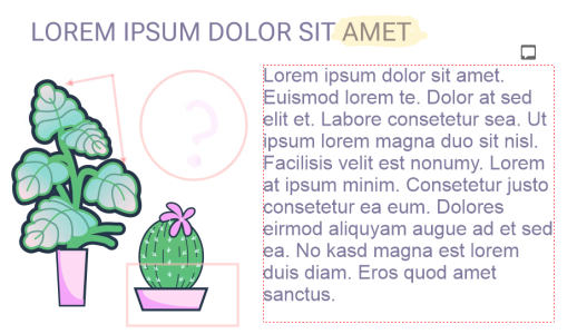

After signing in, you can select, respond to, and resolve comments as well as reopen resolved comments. You can add a note icon, and then type a comment in the Comments inspector, or you can mark up the document with arrows, rectangles, ellipses as well as straight and free-form lines. To draw attention to a specific area in a document, you can highlight it as if you were using a highlighter on paper. You can add a comment to clarify each mark that you draw.
To customize the shapes and lines used as marks, you can choose their color, line thickness, or outline width before or after you draw them. Plus, you can move and resize them.

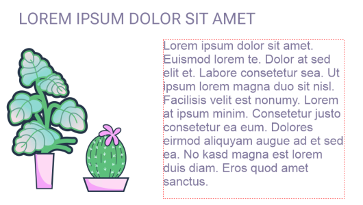

To work on your editing tasks with ease, you can hide all comment marks at any time. All resolved comments are hidden by default, letting you focus on comments that need to be addressed. You can choose to show resolved comments.

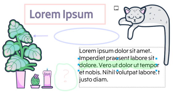

To use drawing markup tools
In the
Comments inspector, perform a task from the following table:
Draw an arrow or a straight line
Click the Arrow Markup tool  . In the drawing window, drag to draw the arrow. To add an arrowhead at the start point, enable the Start arrow check box.
To draw a straight line, disable the Start arrow check box and the End arrow check box. Point to where you want to start the line, and drag to draw the line.
You can choose the color of arrows and lines from the Line color picker.
You can specify the width of arrows and lines by typing a value in the Line width box.
Click the Highlighter tool  , and drag across the area you want to highlight.
You can choose the color of highlights from the Highlight color picker.
You can specify the width of highlights in the Highlight width box.
Draw a free-form line or shape
Click the Freehand Markup tool  , point to where you want to start, and drag in the drawing window.
You can choose the color of lines from the Line color picker.
You can specify the width of lines in the Line width box.
Click the Rectangle Markup tool  , and drag in the drawing window.
You can choose the color of the outline from the Outline color picker.
You can specify the width of the outline in the Outline width box.
Click the Ellipse Markup tool  , and drag in the drawing window.
Draw filled rectangles or ellipses
Select the Rectangle Markup tool  or Ellipse Markup tool  , choose a fill color from the Fill color picker, and then drag in the drawing window.

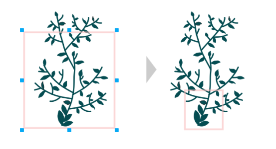

To resize comment marks
Using the
Pick tool
, click a comment mark such as a line, highlight, rectangle, an arrow or an ellipse in the drawing window.
Drag a selection handle.
The rectangle was resized to focus on a specific area of the design.
You cannot resize comment marks drawn by other users.
Notes cannot be resized.

To hide and show comments
Click the
Pick tool
In the
Comments inspector, click the
Preferences button
, and perform a task from the following table.
Hide or show all comment marks
Click Show Annotations to disable or enable the command.
Hide or show resolved comments and their marks
Click Show Resolved to disable or enable the command.
