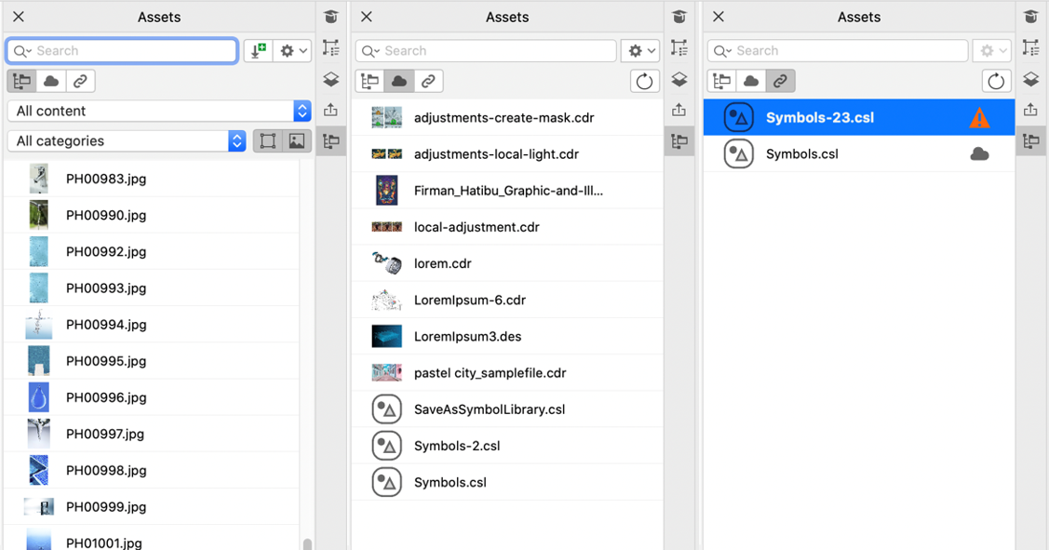

The Assets inspector provides three views to help you work with your content. The Local and network assets view shows vector and bitmap images and other assets that are stored in local or network folders. The Cloud assets view shows the files in your Cloud folder, including symbol library files that are shared with you. The Linked assets view shows the symbol libraries linked to the active document.
The Assets inspector replaces the Connect Content inspector from earlier versions.
Views from left to right: Local and network assets, Cloud assets, Linked assets
You can view the full name and location of an asset in any view.
Assets can be displayed as a list of filenames accompanied by thumbnails (default view) or as a grid of thumbnails. Also, you can increase and decrease the size of asset thumbnails.

In the Assets inspector (Window Inspectors Assets), perform a task from the following table.
To show only
Do the following
Assets saved to local and network folders
Click the Local and network assets button .
Files saved or shared to your Cloud folder
Click the Cloud assets button .
If you are not signed in to Cloud, you will be prompted to sign in to access your Cloud files.
Linked symbol libraries
Click the Linked assets button .
