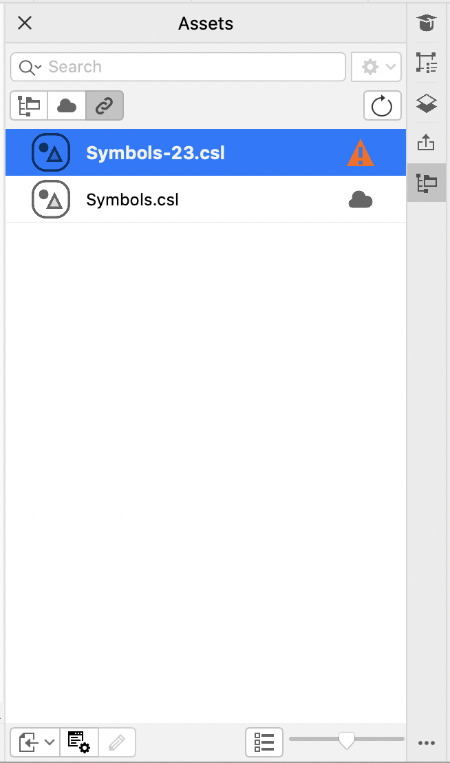

In some cases, the link between a document and a symbol library may be broken. For example, renaming or moving a linked symbol library breaks its link to the document. An icon beside the linked library name shows that the link is broken. You can restore the link to the symbols library to regain access to the symbols in the library.
Linked assets view. Two symbol libraries are linked to the document. The link of the first symbol library is broken and needs to be restored.
