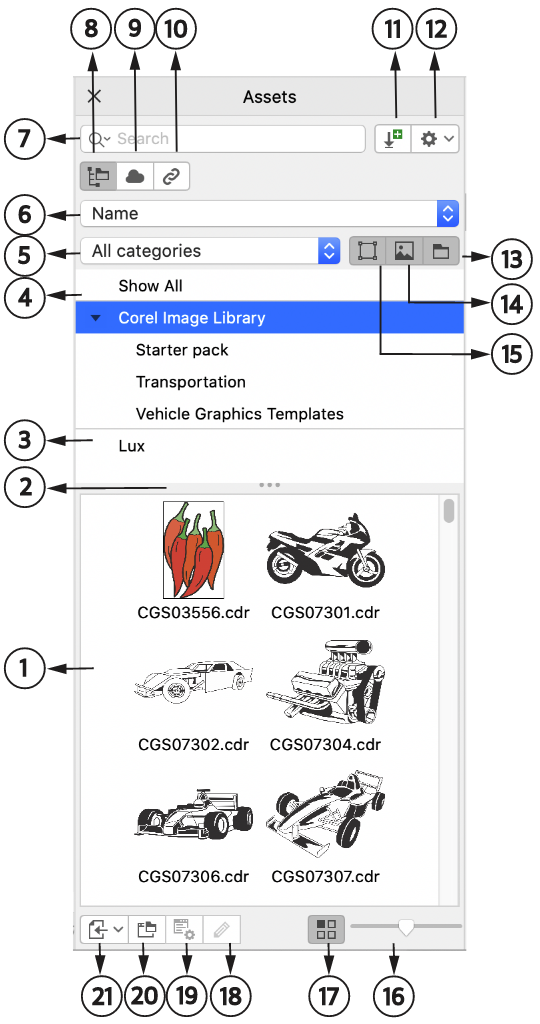

Explore the Assets inspector
The image below shows the main components of the Assets inspector in Local and network assets view.
Part
Description
1. Content pane
Lets you view thumbnails of content files
2. Resizing bar
Lets you resize the Content and Folders panes
3. Folders pane
Displays content in a hierarchical tree-like folder structure
4. Show All
Lets you explore the content in all folders including default libraries, as well as user-added folders and sub folders
5. Filter content
Lets you filter content by category
6. Sort content
Lets you sort content by name and date as well as view your favorite images
7. Search box
Lets you search for files by using search terms
8. Local and network assets
Lets you access vector and bitmap images and other assets that are stored in local or network folders
9. Cloud assets
Lets you access files in your Cloud folder, including symbol library files that are shared with you
10. Linked assets
Lets you access symbol libraries linked to the active document
11. Get More
Lets you access the Get More dialog box that allows you to download apps and plug-ins as well as content such as fill packs, image packs (clipart and photos), and font packs from within CorelDRAW
12. Preferences
Lets you access the following menu commands:
Single-Folder Selection Mode — lets you toggle between selecting a single folder and selecting multiple folders in the Folders pane
Browse Recursively — lets you browse or search all items in the selected folder and subfolders
Add Folder — lets you add a location to the Folders pane
Browse — lets you change the location of a folder
Open Folder Location — lets you quickly open a folder location in Finder without the need to manually navigate to it
Reindex Folder — lets you index a folder for faster viewing, browsing, and searching
Rename — lets you rename a folder in the Folders pane
Remove from List — lets you remove a location from the Folders pane
Help — lets you access the help topic on asset management
13. Browse folders
Lets you toggle between displaying and hiding the Folders pane when viewing local and network assets
14. Show raster images
Lets you hide or show clipart and vector graphics in the Content pane
15. Show vector images
Lets you hide or show photos and other bitmaps in the Content pane
16. Thumbnail size slider
Lets you adjust the size of thumbnails in the Content pane
17. Thumbnail preview
Lets you switch between list and grid view in the Content pane
18. Edit
Lets you open and edit an image
19. Properties
Lets you tag, delete, and edit the properties of a local or network asset
20. Open Folder Location
Lets you open a folder location in Finder
21. Place
Lets you import content in the active document
