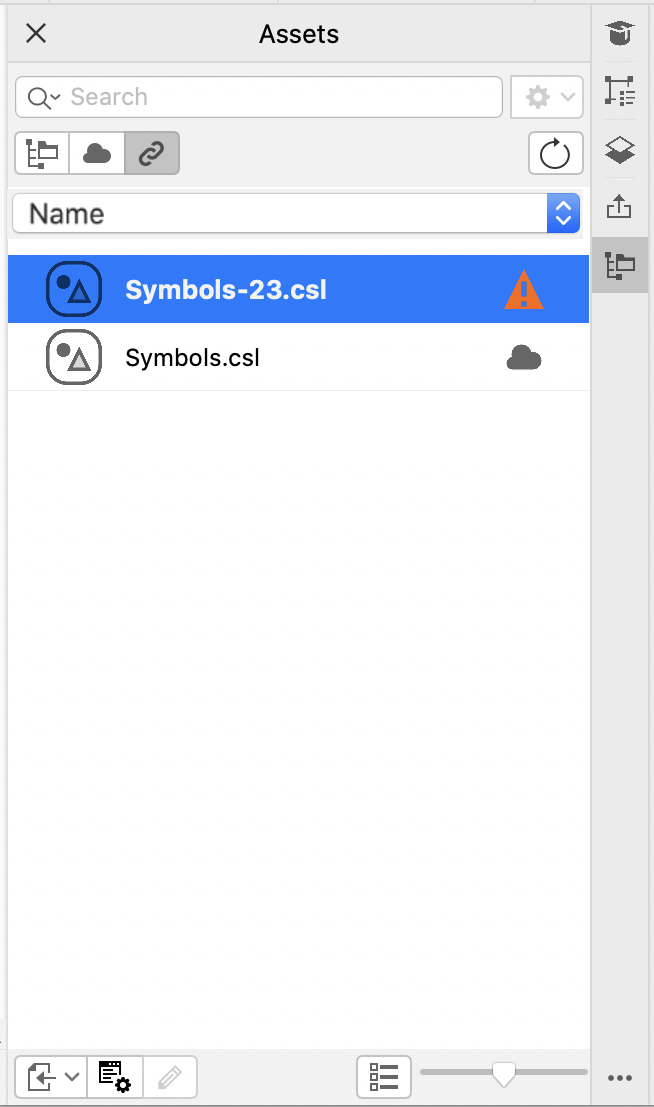

In some cases, the link between a document and a symbol library may be broken. For example, renaming or moving a linked symbol library breaks its link to the document. An icon beside the linked library name shows that the link is broken. You can restore the link to the symbols library to regain access to the symbols in the library.
Linked assets view. Two symbol libraries are linked to the document. The link of the first symbol library is broken and needs to be restored.

1 In the Assets inspector (Window Inspectors Assets), click the Linked assets button .
2 Perform a task from the following table.

Restore the broken link of a symbol library
Control-click a symbol library with a broken link, and click Restore link. If you are restoring the link to a local symbol library that was moved or renamed, the Restore dialog box appears, letting you browse to the symbol library.
Note: You can’t restore the link to a shared symbol library if the file owner has unshared the file. However, you can remove the symbol library from the list by Control-clicking the file, and clicking Break link.
