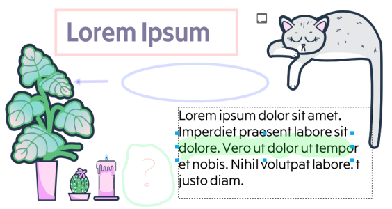

To use drawing markup tools
Back to Top
1 In the Comments docker, perform a task from the following table:
To
Do the following
Draw an arrow or a straight line
Click the Arrow Markup tool . In the drawing window, drag to draw the arrow. To add an arrowhead at the start point, enable the Start arrow check box.
To draw a straight line, disable the Start arrow check box and the End arrow check box. Point to where you want to start the line, and drag to draw the line.
You can choose the color of arrows and lines from the Line color picker.
You can specify the width of arrows and lines by typing a value in the Line width box.
Add a highlight
Click the Highlighter tool , and drag across the area you want to highlight.
You can choose the color of highlights from the Highlight color picker.
You can specify the width of highlights in the Highlight width box.
Draw a free-form line or shape
Click the Freehand Markup tool , point to where you want to start, and drag in the drawing window.
You can choose the color of lines from the Line color picker.
You can specify the width of lines in the Line width box.
Draw a rectangle
Click the Rectangle Markup tool , and drag in the drawing window.
You can choose the color of the outline from the Outline color picker.
You can specify the width of the outline in the Outline width box.
Draw an ellipse
Click the Ellipse Markup tool , and drag in the drawing window.
Draw filled rectangles or ellipses
Select the Rectangle Markup tool or Ellipse Markup tool , choose a fill color from the Fill color picker, and then drag in the drawing window.
2 Type a comment in the Comments docker, and press Enter.

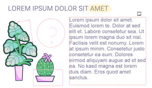

Customized comment marks
50% transparency is applied to the colors of the markup.
You can also customize a comment mark after it is added in the drawing window. Using the Pick tool , click the comment mark in the drawing window, and then set the color and line properties you want in the Comments docker.

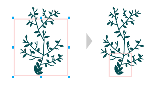

To resize comment marks
Back to Top
1 Using the Pick tool , click a comment mark such as a line, highlight, rectangle, an arrow or an ellipse in the drawing window.
2 Drag a selection handle.
The rectangle was resized to focus on a specific area of the design.
You cannot resize comment marks drawn by other users.
Notes cannot be resized.
