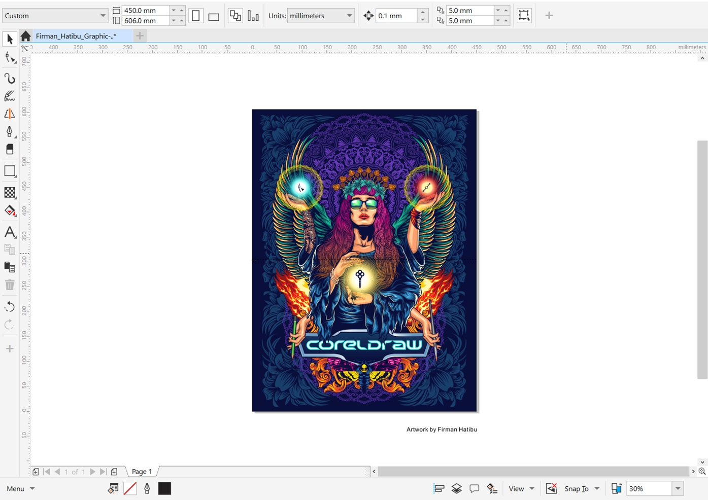

Touch workspace
Optimized for touch-enabled devices, the Touch workspace is ideal for field work and sketching. It allows you to complete your tasks by using touch, dial, and a stylus, without needing a mouse or keyboard.
The Touch workspace has streamlined user interface (UI) that shows you only the tools and commands that you are most likely to use when using a tablet. In comparison to the other available workspaces, the Touch workspace features the following changes:
Buttons and other UI elements are bigger to be touch-friendly.
The toolbox is modified to include only tools you are likely to use often.
The toolbox lets you access Undo and Redo commands as well as Copy, Paste, and Delete.
The menu bar is no longer at the top of the main window. You can access menu commands by clicking the Menu button in the lower-left corner of the status bar.
The status bar lets you quickly change the zoom level as well as access commonly used commands and dockers.
The Touch workspace in CorelDRAW
