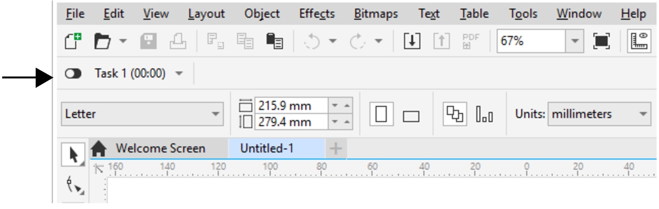

The Project Timer toolbar appears below the standard toolbar.
The arrow on the Project Timer toolbar lets you show and hide the Project Timer panel, where you can add and edit tasks and access various settings.
