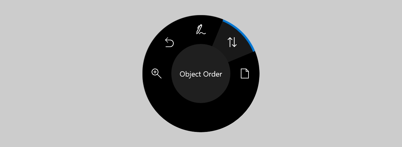

Off-screen mode
When the wheel device is off the screen, its on-screen interface lets you zoom in and out as well as undo and redo actions. In addition, you can now navigate the pages of your document, and you can change the object order by moving selected objects to the front or back of other objects. Plus, your wheel device can help you use the LiveSketch tool more efficiently. For more information, see Wheel devices and the LiveSketch tool.
The on-screen UI of surface dial when used in off-screen mode in CorelDRAW.

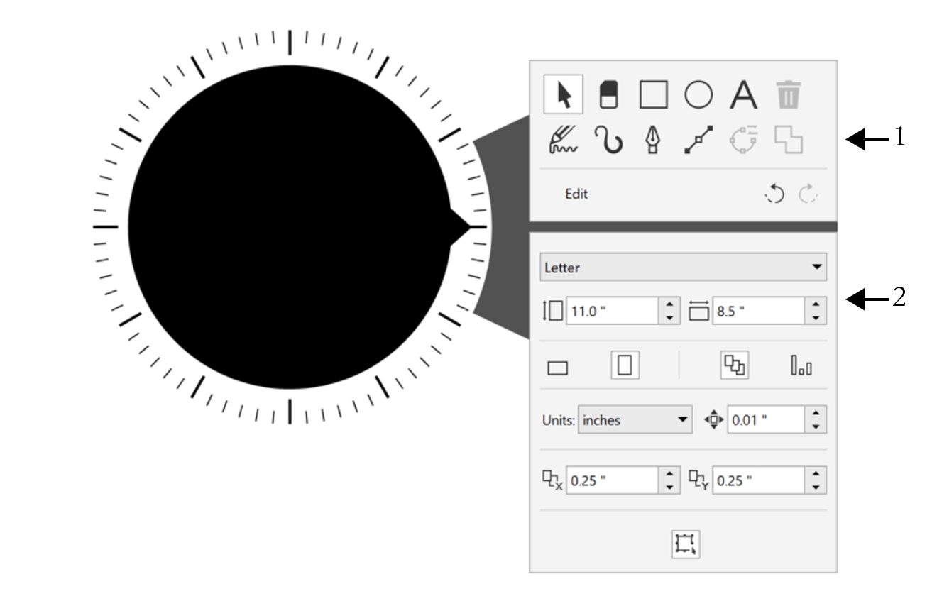

On-screen mode
In on-screen mode (when you place the wheel device on the screen), the on-screen UI is designed to simulate an artist’s palette, giving you quick access to tools and controls through the Tool and Property panels. To select a tool or control on the on-screen UI, you need to use your stylus, or you can simply tap on a touch-screen enabled device.
The default Tool panel lets you switch between the following tools: Pick, Eraser, Rectangle, Ellipse, Text, Pen, and Bézier. You can also access commonly used commands such as Delete, Convert to curves, and Weld.
From the Property panel, you can adjust document, tool, and object settings. For example, you can change the document dimensions and orientation as well as the unit of measurement.
The Tool panel (1) and the Property panel (2) appear when you place the wheel device in the drawing window.

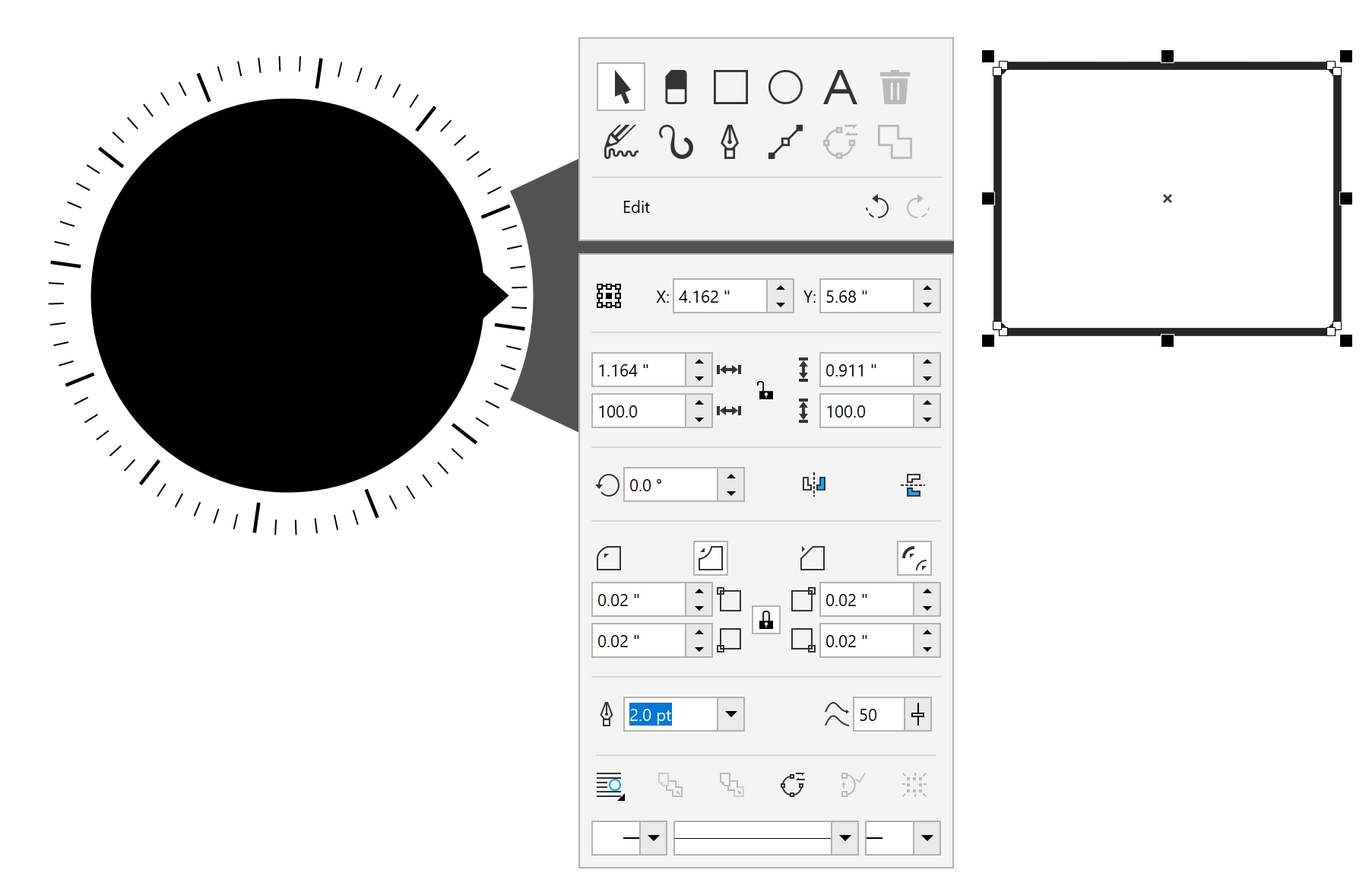

The Property panel is similar to the property bar. It includes controls that are relevant to the selected tool and object. Each time you switch tools on the Tool panel, the Property panel is updated to allow you to edit tool and object properties on the fly. For example, if you have an object selected in the drawing window, you can use the Property panel to quickly adjust object width, height, and outline width; and you can mirror and rotate the object. In addition, if you need to adjust property values, the wheel device can help you fine-tune them with precision.
The Property panel displays controls that let you edit the selected object, a rectangle in this example.

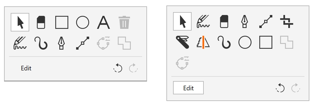

To tailor the Tool panel to your workflow and have a non-cluttered yet complete collection of tools at your fingertips, you can remove, add, and rearrange tools.
Left: The default Tool panel. Right: A customized Tool panel. In this example, new tools (Crop, Knife, and Smart Drawing) are added; the Delete button is removed; and the tools are rearranged.

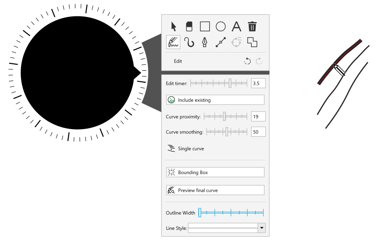

Your wheel device can be especially helpful when you are sketching with the LiveSketch tool. In off-screen mode, you can use the wheel device to easily undo and redo your strokes. In on-screen mode, you can fine-tune the time it takes to adjust strokes, and set other tool and stroke properties. Plus, you won’t need to use a keyboard to reset the timer and have your strokes adjusted instantly in both modes of the wheel device.
The Property panel displays controls related to the LiveSketch tool.
To use a wheel device in off-screen mode
Back to Top
1 Press down the wheel device to show the on-screen menu, and then release.
2 Rotate the wheel device to select one of the following commands on the on-screen menu, and click.
Zoom — lets you zoom in and out
Undo — lets you undo and redo actions
LiveSketch — lets you undo and instantly adjust strokes when using the LiveSketch tool. For more information, see To use the LiveSketch tool with a wheel device in off-screen mode.
Object Order — lets you move the selected object up or down in the stacking order
Page — lets you navigate the pages of your document
3 Rotate the wheel device clockwise or counterclockwise to complete your task.
To choose tools and adjust properties using a wheel device in on-screen mode
Back to Top
1 Place the wheel device on the screen with your nondominant hand.
The Tool and Property panels appear beside the wheel device.
2 Perform a task from the following table by using a stylus or mouse.
To
Do the following
Adjust document properties
Make sure that no object is selected in the drawing window. Select the Pick tool on the Tool panel. On the Property panel, select a control. To adjust values, rotate the wheel device clockwise or counterclockwise.
Choose a tool
Select a tool on the Tool panel.
Adjust tool and object properties
Select the control you want on the Property panel. To adjust values, rotate the wheel device clockwise or counterclockwise.

To customize the Tool panel
Back to Top
1 Place the wheel device on the screen.
2 Using your stylus or mouse, select Edit on the Tool panel.
The Customization panel opens.
3 Perform a task from the following table.
To
Do the following
Add a tool
Drag the tool from the Customization panel to the Tool panel.
Delete a tool
Drag the tool out of the Tool panel.
Reposition a tool
Drag the tool to a new position in the Tool panel.
Add, remove, and rearrange tools to customize the Tool panel.

To use the LiveSketch tool with a wheel device in on-screen mode
Back to Top
1 In CorelDRAW, tap the LiveSketch tool in the toolbox.
2 Place the wheel device on the screen to show the on-screen menu.
3 Perform any of the tasks from the following table.
To
Do the following
Adjust LiveSketch settings
Using a stylus or a mouse, select the control you want on the Property panel. To adjust values, rotate the wheel device clockwise or counterclockwise.
Reset the timer and adjust strokes instantly
As you are sketching with the LiveSketch tool, click the wheel device when you want to finalize the stroke before the delay time has elapsed.
Without a wheel device, you can reset the time and adjust the strokes instantly by pressing Enter.
