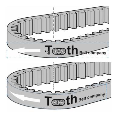

A custom envelope (3) is created from the shape of a vector object (1) and applied to a bitmap (2).
