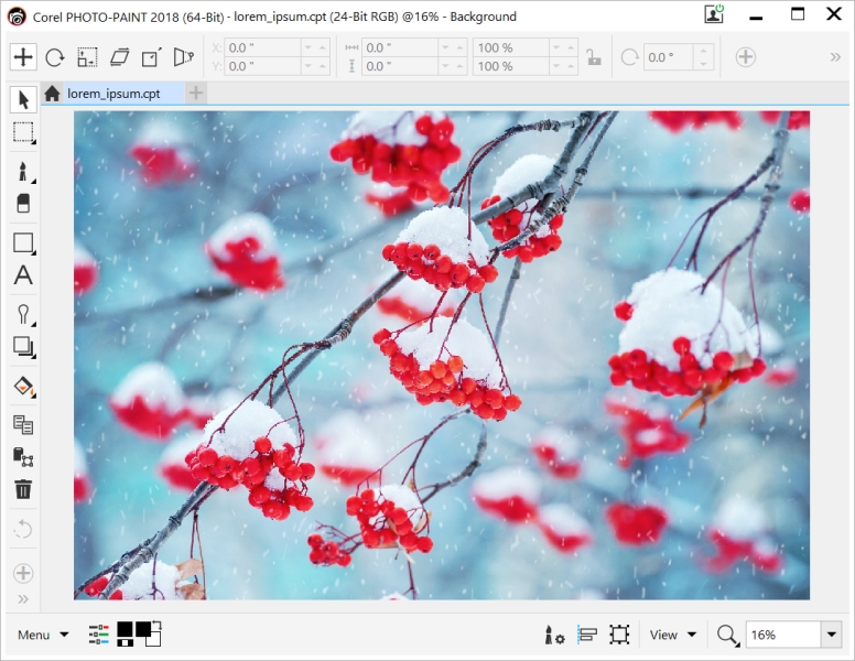

The Touch workspace in Corel PHOTO-PAINT
