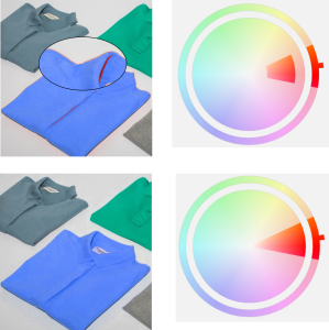

An orange color was selected from the image.
The orange in the shirt is replaced with blue, but some orange and red colors still remain (top). The saturation range is adjusted to select and replace those colors (bottom).

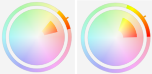

Adjust the selected hue range
Point to one of the edges of the color band on the Hue range ring, and when the hand cursor appears, drag up and down.
To shift the entire hue range of selected colors, click the handle of the color band on the Hue range ring, and drag around the ring.
Note: When the color band is small, only pixels that are very similar to the color you selected are selected and replaced; when the color band is bigger, more pixels are selected and replaced.
Adjusting the selected hue range
Adjust the saturation range of a hue’s shades to be included in the selection
Point to the inner or outer edge of the color band on the Saturation range circle, and drag when the pointer changes to a hand.
