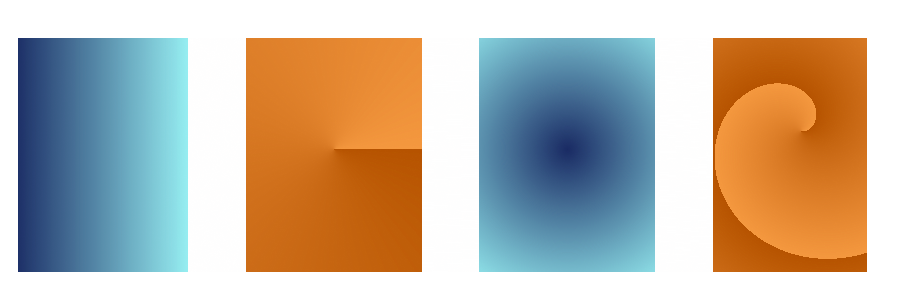

Gradients types: (left to right) linear, conical, circular, and spiral

• Linear Gradient
• Radial Gradient
• Circular Gradient
• Spiral Gradient
Tip: You can also set the gradient type by choosing Window Media Panels Gradients, clicking a gradient in the Painter Gradients area, and choosing a gradient type.
