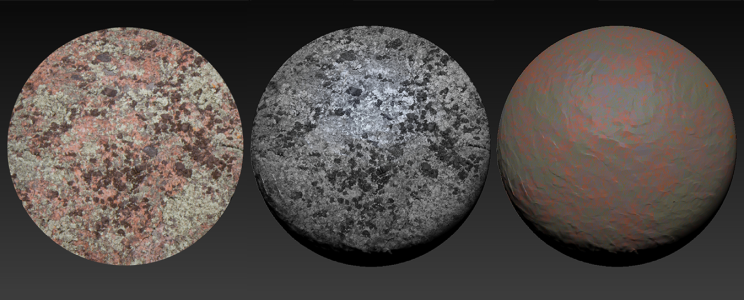

There are a number of different methods that allow you to specify whether a Texture brush uses the color, luminance, or both the color and luminance information of a selected texture and whether it interacts with paper grain.
An example of a Texture brush variant (left), a Grainy Texture Luminance brush variant (middle), and a Grainy Texture Chroma variant (right)

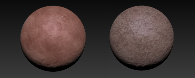

You can control the amount of texture that a brushstroke reveals.
A brush with (left) 50% Strength and (right) 100% Strength

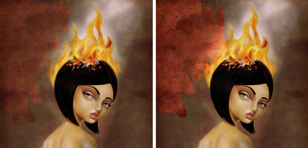

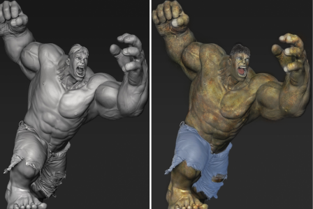

You can also specify how Texture brushes interact with paint already applied to the canvas. For example, Texture brushes can either cover or blend with the underlying image to create amazing effects.
A 3D rendered model (left); a texture is blended into the image (right). Model by Mike Thompson.

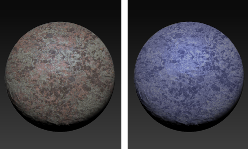

Texture brushes can use the original texture color or mix the texture color with a different color. For example, if the texture that you want to use doesn't match the tone and color of your composition, you can sample a color from your painting and mix it with the texture color. You can choose an expression such as pressure, tilt, direction to vary the amount of color you mix into the texture. For more information, see Expression settings.
An example of a Texture brush that uses the original texture color (left). The original texture color is mixed with the selected color (right).
You can smudge a texture. Smudging reveals a little of the current texture as you push, pull, and smear pixels. You can choose a fixed amount of smudging or vary the effect with an expression. For example, if you link smudging to stylus pressure, light pressure will reveal more texture detail, increased pressure will reveal less detail.
An example of a Texture brush with smudging (left) and without smudging (right)

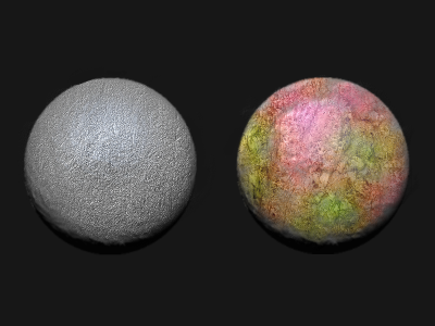

For even more astonishing results, you can use dab stencils to shape the dab and modify the opacity of Texture brushes. For information about dab stencils, see Dab Stencil controls.
Texture brushes can have depth and support the impasto Depth and Color and Depth drawing methods. Corel Painter uses the luminance (brightness) information in the texture to determine how much depth is applied within a stroke. Light areas of the texture receive more depth; dark areas receive less. Black areas appear flat. For more information about impasto methods, see Adjusting and creating Impasto brushes. You can add or remove depth, and control the effect by manipulating the lighting of the painted result. Add depth to Texture brushes to create pores on skin, scales on a lizard, thick brick walls, and prickly pebble board.
An example of a Texture brush that uses the impasto Depth method (left) and the impasto Color and Depth method (right)

4 On the General panel (Window Brush Control Panels General), choose one of the following methods from the Subcategory list box:
Texture — uses both the color and luminance information of the texture
Grainy Texture — works like Texture but also interacts with paper grain
Texture Luminance — uses only the luminance (lighting) information of the texture
Grainy Texture Luminance — works like Texture Luminance but also interacts with paper grain
Texture Chroma — uses only the color information of the texture
Grainy Texture Chroma — works like Texture Chroma but also interacts with paper grain
