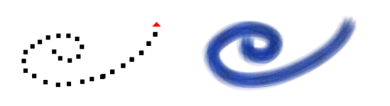

When you draw a freehand stroke, you can drag with any motion or in any direction. The stroke follows your path.
Dragging to create freehand strokes

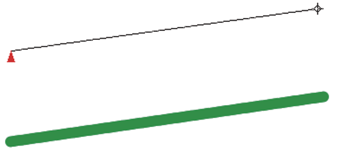

When you draw a straight line stroke, Corel Painter connects points with a straight line.
To create a straight line stroke, you click to add the first point and then click or drag to create the stroke.

1 On the Brush property bar, click the Straight line strokes button .
2 Click a point on the canvas where you want to start your line.
3 Do one of the following:
• Click the point where you want to end the line.
• Drag to place the end point exactly where you want it.
Corel Painter connects the first and second points with a straight line.
4 To continue drawing from the second point, click or drag to create additional points on the canvas.
Corel Painter connects each point with a straight line.
