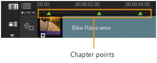

To add chapters
Select Chapter Point in the Chapter/Cue Menu.
4
To remove chapters and cues, drag the markers outside the Timeline ruler and release the mouse button. You can also drag the Timeline ruler to a chapter or cue point and click Add/Remove Chapter Point or Add/Remove Cue Point.
You can also drag the Timeline slider to the desired chapter point position in your project. Click the Add/Remove Chapter Point.
