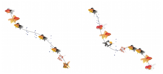

Objects sprayed along a curved line (left). The objects and line were edited after the objects were sprayed (right).
