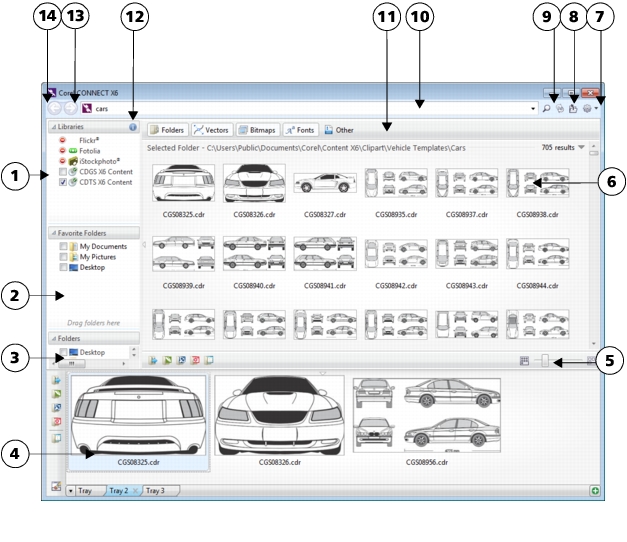

You can browse and search for content by using Corel CONNECT. Corel CONNECT is available both as a standalone utility and as a docker. You can choose whichever mode better suits your workflow.
The image below shows the main components of the Corel CONNECT utility:
In docker mode, the search utility has two components: Connect docker and Tray docker. The Connect docker has two viewing modes: single pane and full view. In full view, all panes are displayed. In single-pane view, either the viewing pane or the Libraries, Favorite folders, and Folders panes are displayed. You can resize the docker to display all panes or toggle between the viewing pane and the Libraries, Favorite folders, and Folders panes.
The Connect docker with the viewing pane hidden (left) and the navigation pane hidden (right). Click the toggle arrow (1) to display or hide panes. Resize the docker to display both panes.
You can also customize the size and display of individual panes.
The grab area (1, 2, 3) lets you resize a pane.
You can use the Favorite folders pane to create shortcuts to folders that you visit frequently. You can add locations to and remove locations from the Favorite folders pane.
