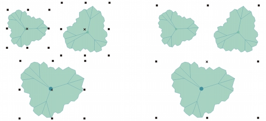

When you group two or more objects, they are treated as a single unit. This feature lets you apply the same formatting and other properties to all objects within the group at the same time. In addition, grouping helps prevent accidental changes to the position of an object in relation to other objects. You can also create nested groups by grouping together existing groups.
Single objects retain their attributes when they are grouped.
You can add objects to or remove objects from a group, and you can delete objects that are members of a group. You can also edit a single object in a group without ungrouping the objects. If you want to edit multiple objects in a group at the same time, you must first ungroup the objects. If a group contains nested groups, you can ungroup all objects in the nested groups simultaneously.
To group objects |
1. |
Select the objects.
2. |
Click Arrange Group.
You can create a nested group by selecting two or more groups of objects and clicking Arrange Group. |
The status bar indicates that a group of objects is selected.
You can select objects from different layers and group them; however, once
grouped, the objects will reside on the same layer, based on the last selected
object.
