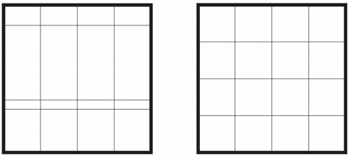

You can resize table cells, rows, and columns. In addition, if you previously changed the sizes of some rows or columns, you can redistribute all rows or all columns so that they are the same size.
If table rows are different sizes (left), you can distribute them so that they are the same size (right).
