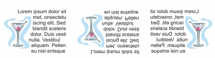

Left to right: Text in original form, mirrored vertically, and mirrored horizontally
