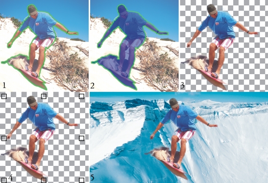

Cutout Lab workflow: (1) Highlight the edges of the image area; (2) Add a fill to the inside. (3) Preview the cutout and touch it up if needed. (4) Bring the cutout into the image window. (5 — optional) Place the cutout against a background image.

Click Image Cutout Lab.
Click the Highlighter tool .
In the preview window, draw a line along the edges of the image area that you want to cut out.
The line should slightly overlap the surrounding background.
4
Click the Inside fill tool , and click inside the area you want to cut out.
5
Click Preview.
If you want to touch up the cutout, click the Add detail or Remove detail tool, and drag over an edge.
6
