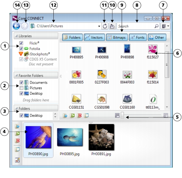

The image below shows the main components of the Corel CONNECT utility:
Part
Description
1. Libraries pane
Lets you access online content as well as content that is included with CorelDRAW Graphics Suite X4 or previous versions of the suite
2. Favorite folders pane
Provides quick access to frequently used folders
3. Folders pane
Displays a representation of the file structure available on your computer
4. Tray pane
Lets you collect files from one or more folders
5. Zoom slider
Lets you adjust the size of thumbnails in the viewing pane
6. Viewing pane
Lets you view thumbnails of content files
7. Help button
Lets you launch the Help system
8. Search box
Lets you search for files by using search terms
9. Filter toolbar
Lets you choose which type of content to display in the viewing area: folders, vector images, bitmap images, fonts, or files saved to file formats that are not supported by CorelDRAW Graphics Suite
10. Go to parent folder button
Lets you go one level up from the current folder
11. Refresh/Cancel button
Reloads the results from your last search or initiates a new search based on the criteria that you have specified. When a search is in progress, the button changes to the Cancel mode , which allows you to stop a search at any time.
12. Address bar
Shows the full path to the current location
13. Navigate forward button
Takes you to the next page of content
14. Navigate back button
Takes you to the previous page of content

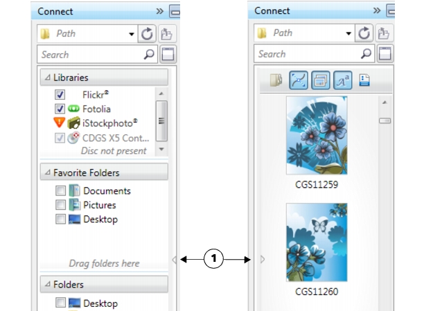

In docker mode, the search utility has two components: Connect docker and Tray docker. The Connect docker has two viewing modes: single pane and full view. In full view, all panes are displayed. In single pane view, either the viewing pane or the Libraries, Favorite folders, and Folders panes are displayed. You can resize the docker to display all panes or toggle between the viewing pane and the Libraries, Favorite folders, and Folders panes.
The Connect docker with the viewing pane hidden (left) and the navigation pane hidden (right). Click the toggle arrow (1) to display or hide panes. Resize the docker to display both panes.

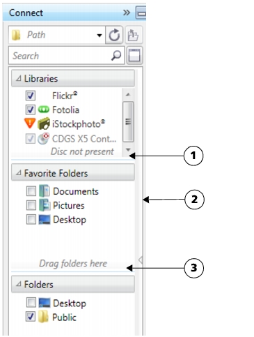

You can also customize the size and display of individual panes.
The grab area (1, 2, 3) lets you resize a pane.
