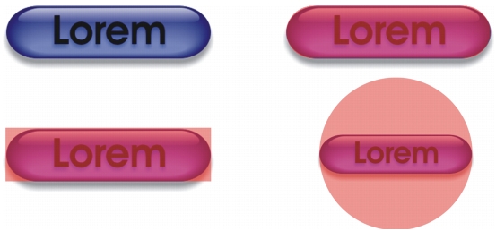

The hotspot on the left button is rectangular, while the hotspot on the right button is circular. Clicking anywhere on the hotspot activates it.
