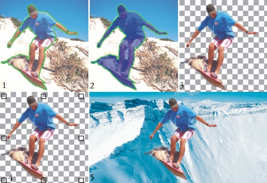

Cutout Lab workflow: (1) Highlight the edges of the image area; (2) Add a fill to the inside. (3) Preview the cutout and touch it up if needed. (4) Bring the cutout into the image window. (5 — optional) Place the cutout against a background image.

In the preview window, draw a line along the edges of the image area that you want to cut out.
The line should slightly overlap the surrounding background.
4.
Click the Inside fill tool , and click inside the area you want to cut out.
5.
Click Preview.
If you want to touch up the cutout, click the Add detail or Remove detail tool, and drag over an edge.
