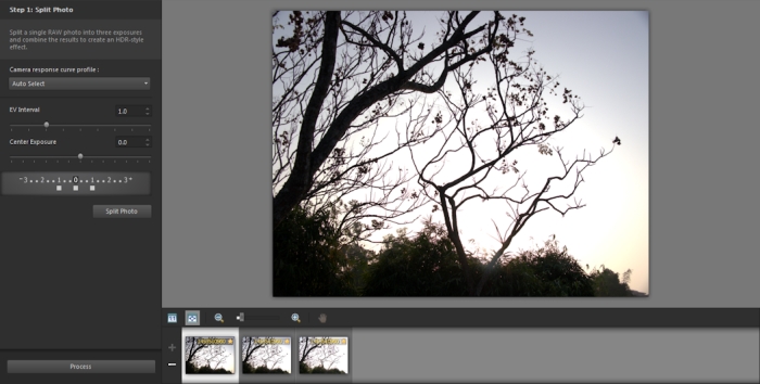

| To choose merge options for Exposure Merge (Step 1) |
| 1 | In the Manage workspace, select the thumbnails for the photos that you want to merge. |
| An orange outline appears around the thumbnails of selected photos. |
| 2 | Click File |
| 3 | In the Step 1: Merge window, choose a profile from the Camera response curve profile drop-list. |
| If you are not sure what to choose, select Auto Select. |
| If the EV interval slider appears, set the exposure value that you used between photos. |
| 4 | In the Alignment area, choose an alignment type from the Method drop-list. |
| If you want to crop any edges that don’t overlap, mark the Auto crop check box. |
| 5 | Click Align. |
| To see the results, enable the Preview Alignment check box (near the bottom of the panel). |
| 6 | If you want to keep or remove specific areas from individual photos, use the controls in the Custom editing area. See To brush in or brush out artifacts in Exposure Merge. |
| 7 | Click Process. |
| The merge settings are applied and the Step 2: HDR Adjustments window appears. |
| If you want to tweak your merge settings, click Back to return to the Step 1 window. |
