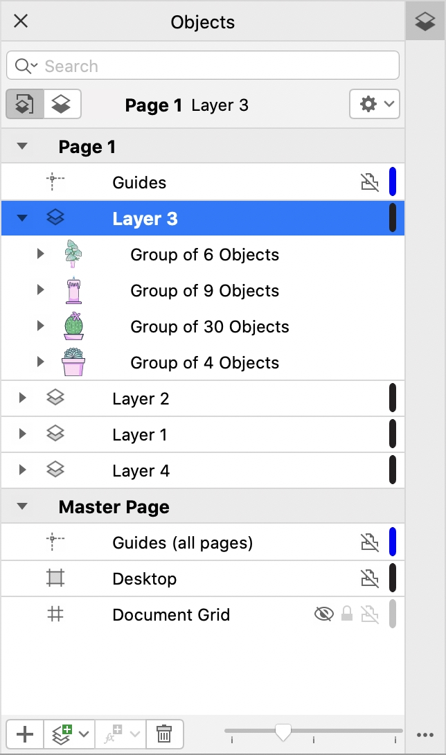

The icons to the right of a layer’s name let you change the layer’s properties.

To hide or show a layer
Back to Top
1 If the Objects inspector is not open, click Object Objects.
2 Point to the layer name, and click the eye icon .
To show the layer, click the eye icon.
Objects on a hidden layer are displayed in the printed or exported drawing unless the layer’s printing and exporting properties are disabled. For more information, see To enable or disable printing and exporting of a layer.
You can also show or hide a layer by control-clicking the layer in the Objects inspector and then clicking Show or Hide.
2 Click the printer icon beside the layer name.
2 In the Objects inspector, click the name of the layer that you want to edit.

Lock or unlock a layer
Control-click the layer name, and click Lock. To unlock a layer, click the lock icon beside the layer name.
Allow editing on all layers
Click the Preferences button , and then click Edit Across Layers to enable the command.
Allow editing on the active layer only
Click the Preferences button , and then click Edit Across Layers to disable the command.
