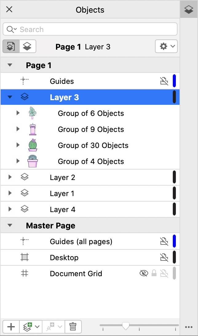

The Objects inspector displays the default layer structure. The names of the active page and layer appear at the top.
